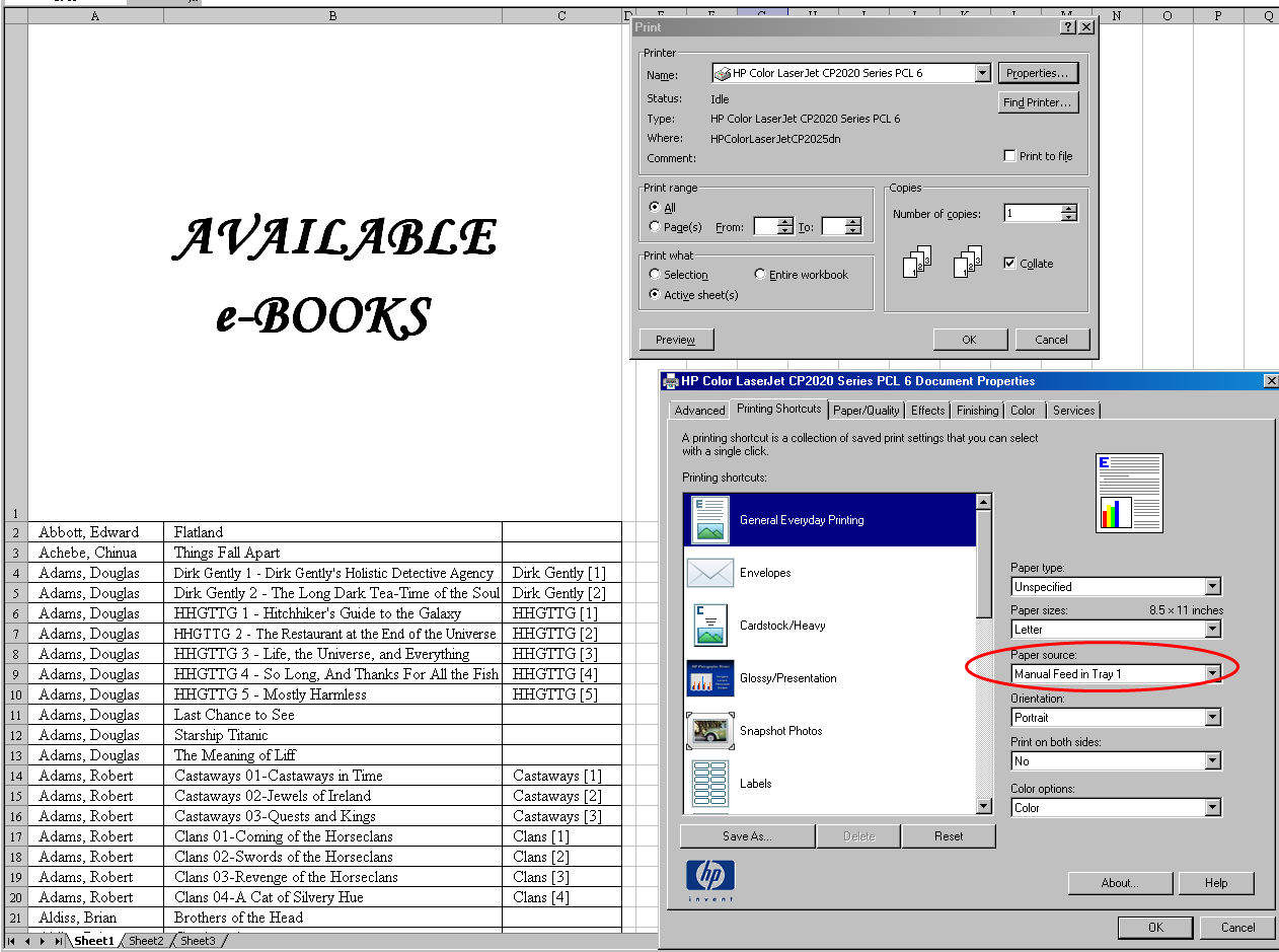

That takes me to the same dialog I get to any time I click on the "Print Options" button in any application. In other words, I go to print an Excel file and I know it is going to call for "Manual Tray 1" so before I click "OK" to print the file I click "Options" in order to set the tray selection to "Automatic".
I am calling up the PCL6 dialog box from my application in order to set up the printer. The frustrating part is, the default is "Automatic", because the "Reset" button in the PCL6 dialog is lit up ready to click and when I click it, it does reset the tray selection properly. However, this change to the correct default will be in effect only until I close the file. After that, if I open the file again, it will be back to "Manual Tray 1".
And, if I open an older file, one created before this problem began plaguing me, the tray select default will be correct, i.e., "Automatic".
Something in MS Word, Excel, Acrobat, and no doubt a few other programs, is telling PCL6 to change the tray selection for the particular print job to "Manual Tray 1" instead of the default "Automatic". Below is a screen shot of what my "Options" screen looks like. If I click that "Reset" button, it will change it to the default setting of "Automatic" for the paper source.
Right. If you enter the print properties from the application with a document open, that controls how that particular document is going to print. If you open the printer properties from the Start Menu, that sets the system defaults.
The interesting part is how it's changing away from the defaults when you open a document. Perhaps in this case, your printing preferences are cleverly getting saved with the document? Have you tried:

Yes.And if it is a newer document, created after the problem began, the fix lasts only until I close and re-open the file.
Except...
Just to humor you, I took a known "bad" file, checked the options and sure enough it was "Manual Tray 1", changed it to "Automatic", then saved the file. From that point onward, the file was fixed permanently, contrary to previous experiences AND EVERY OTHER FILE I CAN FIND, NEWER, OLDER, FRESHLY CREATED, EXCEL, WORD, ACROBAT, PAINT... I CANNOT find a file that now is set to "Manual Tray 1".
Yes. That's what was getting at. It's the exact same window, but if you approach it from the system side instead of the application side, the change becomes the default instead of a single-time change.
Did you sneak past my firewall and fix it, and now you're just messing with me? smile smile
Are you sure you made that change by going to the print dialog within a file? Or did you make it when you had the printer preferences open from the way I told you? When you got to it the way I said, was Word still open?

Yes. MS Word --> Print --> Properties --> Paper Source
Don't know, but I did set the defaults earlier through the system rather than through the application, and I think that must be what made everything right with the world. Don't know why that one file still had the wrong paper source setting, but the rest of them seem to be OK now.
